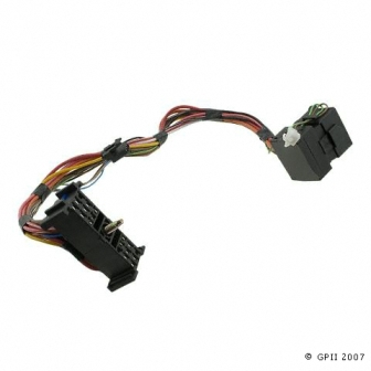

ok.....so if you put the key in and turn it on then press the button 2 times to stop the remote start, does the truck stay running on its own with just the key?? im asking you this because that truck doesnt have VATS or PASSLOCK, and so im thinking you have a bad ignition switch. the brake shutdown wire sounds like its not hooked up as well.

when i psh the butto n twice, the truck shuts down, even with the key on. where is the ignition switch located? doe you know?thank you

Posted: January 20, 2009 at 2:25 PM / IP Logged
just as i thought! you definitly have a bad ignition switch. it  looks like this.

oh! alright i now have a better understanding as to whats going on. now do yyou think i need that replaced or can i just start/ stop my engine with the keypad? and thanks again for you help!
