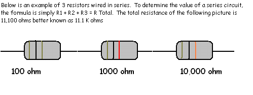

also, can anyone tell me how to wire multiple resistors to get the ohm value needed for installation? and within what tolerance can they be?

Platinum - Posts: 13,716
Posted: February 01, 2009 at 3:30 PM / IP Logged
The tolerance of most door lock systems is pretty forgiving, I have seen them be as far as 20% out and still work.
schematics needed, 2000 dodge durango -- posted image.
