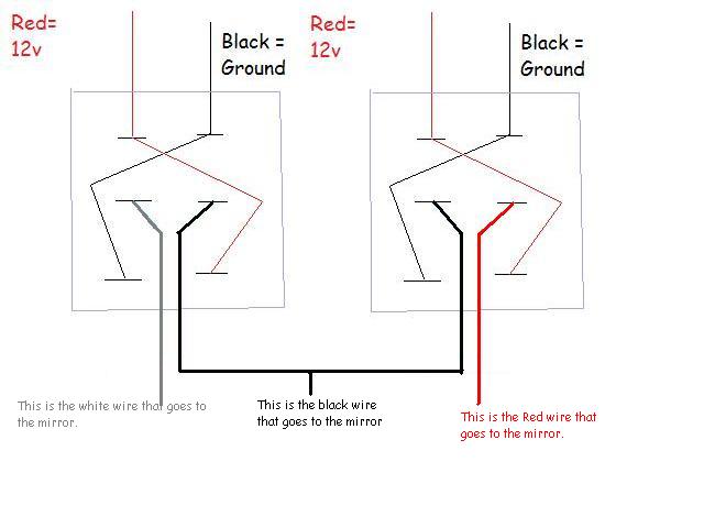

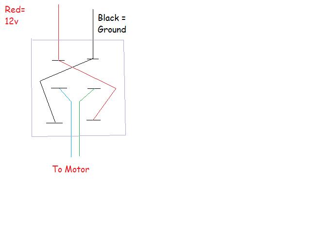

Does red and black move up and down depending on polarity?  Does white and black move left and right depending on polarity?   I need to know which wire is common and which one moves up and down and which one moves left and right.
I have never seen a mirror with only 3 wires, they usually have 4.  If you can answer the questions above, I can modify the picture to make it easier for you to connect it.
wiring electric mirrors -- posted image.
This will require 2 switches, one for up/down  and 1 for left/right.  The switches need to be Double Pole Double Throw, Momentary rocker or toggle switch.

ok i had to verify but yes that is the wiring.
Platinum - Posts: 13,725
Posted: February 16, 2009 at 8:46 PM / IP Logged
You need to make sure you are only moving the mirror one direction at a time, attempting to move up and left at the same time will be a problem.  Be sure to fuse the power wire going to the switch at no more than 5 amps.  The 3 wires at the bottom of the drawing are the wires that go to the mirror.  The Grey wire is the white wire of the mirror.  White was not going to show up on the diagram.  If you get this to work, with one more switch we can make it adjust the passenger side mirror also.

that kewl , that is what i want to do is control drivers and pass.  but do you know of any aftermarket , universal or factory type mirror switch that will work? that is mainly for the apperance only having the mirror control switch rather than 3 switch's
