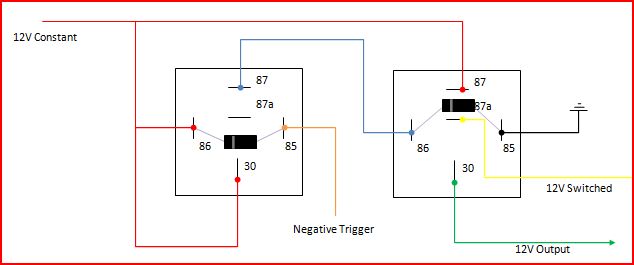

Could someone please validate this diagram, I am by no means an electronics expert but I think this will do what I am looking for:
The scenario:
I have a CarPC that has power supply unit (PSU) designed for car use, the supply has an auto power on ( based on a switched 12v line). I would like to begin the power up process by using my keyfob and the neg trigger from the dome lights to power the PSU's switched line, then when I turn the ignition the switched line would then power the PSU's switched line.
Does this look like a viable solution ??
relay diagram for car pc -- posted image.
Other notes:
The dome lights turn on for a few minutes then power off. this is not an issue because the PSU I have has a shutdown controller.
Also the dome light turn off when the key is turned.
Thanks in advance.

I would put a diode across each coil.  You could probably get away without one on the right relay, but the left relay will need one to protect the transistorized outout of the BCM that wasn't designed to handle inductive loads.
Other then that it looks good and I would think it would work.

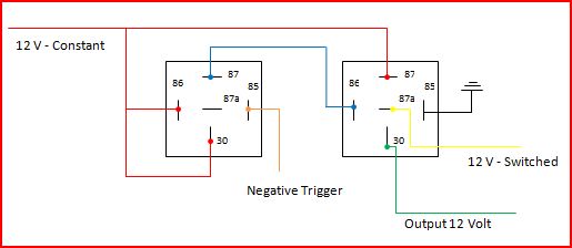

So you would recommend it like this ?

how many amps should the diodes be able to handle ?
would a 1 amp be sufficient or should I get something larger 6A ???

a 1A diode would be fine.

Could the diode just be placed on the negative trigger???
How would I place a diode across the coil ?? does anyone have a picture that shows what this physically looks like ?

No, it has to go across the coil.  You wire the striped side to the (+) side of the coil and the non striped side to the (-) side of the coil.
