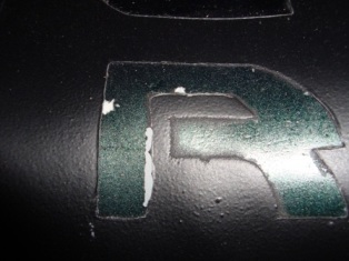

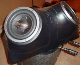

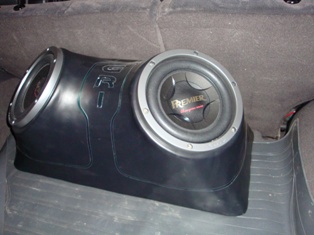

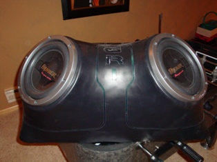

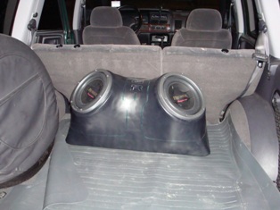

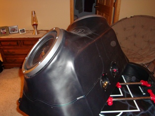

This is the final product of my fiber glass box i made for my 10" pioneer premiers... it took about three months (finished in Sept. '08) and about $80. Its flat black with green stripes to match my jeep.  i also put my initials on it for a more personal touch, although i wish i hadnt because they didnt turn out so hot... the edges peeled a little and it looks kinda cheese close up there... but the design was cool i thought... all in all i think it turned out good for a first time glassing..
thanks to everyone who gave me some input on my other threads and started threads about makin these types of boxes... i couldnt have done it with out this site and your guidance... keep up the good work!

Looks pretty good - any pictures with the box inside the Jeep?

That's fiberglass? maybe it's the paint, it looks like leather to me!
Btw, i'm not complaining, i'm actually complementing.. what did you use to do the lettering?
Nice job for first time man.. nice job!

Thanks for the complements! Yeah, the flash from the camera exposes all the lumps were i didnt sand enough... it got that way cause I thought it would be ok to slop the resin on as thick as i could... that made sanding a pain in the ***...
I did the letters by taking a really glossy notebook cover and laying blue painters tape over it in squares roughly the size of the letters. then i used a hobby knife to cut out the letter shapes i wanted (after taping a print out of the desired shape over the tape).  The glossy notebook cover made it possible to peel off the tape without removing too much of the adhesive.  it was a little bad for adhesive in the corners and there is one letter that has a pretty bad underspray spot, but its not noticable from a distance. the pealing of the green at the edge is much more noticable, cause you can see the grey primer.  i should have put more green down but the can was really small and really expensive (i bought it from a auto body place that sold cans of touch up paint, i wanted the exact green of the outside of my jeep.) I only used 3 coats....

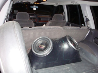

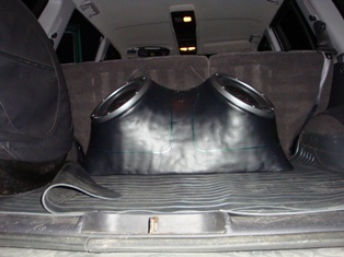

here are the photos you asked for kpierson.  once again i had to use flash : ( cause it was dark...  it looks bigger in person, for some reason the pictures have a tunnel effect that make it look tiny.  my trucks really dirty, so that is why everything looks dusty. she wants a spring cleaning realy bad! and the marks on the back of the fold down seats are from the sub box bottom, i had it sitting with the seats down for a while and the sub box is actually very heavy and leaves carpet indents.  i should have brushed those out... oh yeah, dont mind the mats, i know they are ugly but i only had them in there to defend against the wetness of my snowboarding stuff.
