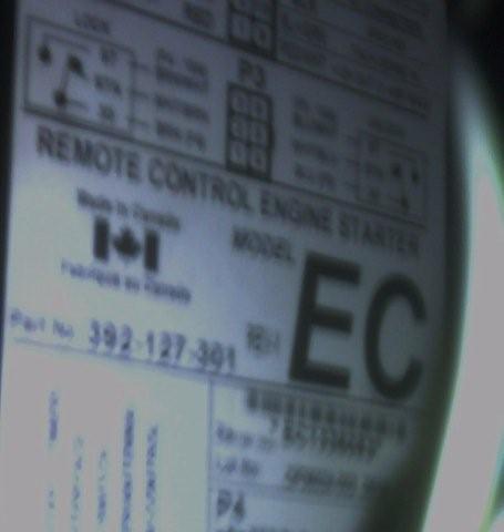

I need to find replacement fobs. I purchased a car that didnt come with fobs. After buying the car i noticed the antenna and followed the wire under the dash. I found the brain and a master key taped up for the remote start. the car is a 2005 toyota corolla s and the alarm is an astroflex part number 392-127-301 rev ec. I used the dealer locator and the dealer is only a mile away but they no longer deal with astroflex and they are having a hard time finding a supplier to get the part from.
also how can i tell what features are installed?
need to find remote for astroflex -- posted image.

turn the unit over and give a MODEL#  anything but the part #
I see in your pic  the connectors P2,3,and 4 No P1 so no alarm, just remote start and keyless.

the only place that I saw the word model it had EC next to it and no numbers.  I will look again today and hopefully get luckier....    Thanks for the reply.

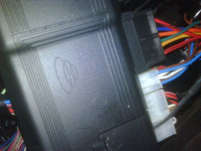

ok I looked again this morning.  it says Astroflex Remote Starter then it says model and next to that a big EC with Rev 1 really small next to the big EC.  There is no actual model number listed.  The serial number is ec1336083.  i tried to capture with a pic but wasnt able to get a readable pic to show you I'm not crazy.

Ok I got somewhat of a readable pic to show that there is no obvious model info.
