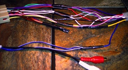

nope not yet... here is a pic, but its prolly not that great.  On the electrical tape, all wires are singled out, but I wanted to reduced the amount of tape so i wraped two wires per tape, bu they are singled out and i have verified it.  This is the best pic i could take (older camera).  Thank for all the help.

By chance do you have the factory radio?and if so have you hooked it back up to see if it still acted up?Oh by the way,it would'nt hurt to solder and heat shrink those wires instead of tape or butt connectors.

factory radio is back in and works perfectly.  I did sodder the wires, just put electrical tape around them afterwards for protection.

Did you hook up the illumination wire(s)and if so are the wires the same colors.It's kind of hard to see exactly what is wired together in the pic.

older radio that does not have illumination wires, also the harness has orange and ORANGE / black wire that is not hooked up.  I also have four mute wires (brown) those are the wires in the middle of the pic that are wrapped with nothing attached.  All the speakers work fine so there is nothing worng with the white, green, purple and gray wires.  All that leaves me with is the yellow (which is hooked up to cooresponding yellow), black (which is hooked up to the cooresponding black), pink/black which is going to solid pink (audio interupt), and red (ignition) which is also hooked up to cooresponding red.  Im confused.
I also have the solid blue wire (power antenna) which is not hooked up to anything, due to no power antenna on the mustangs.  The blue with with the stripe is going to the factory amp which has cooresponding blue with stripe wire (strange that there is no ground for it).
