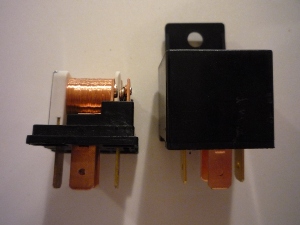

hi all, first time posting....
I have been given a large quanity of Single Pole Double Throw relays, from a surplus supplier,  but none of them have any description printed on them.
Is there any way to tell the rating of the relay?? (ie 30amp, 40amp etc) i have opened one up, but that didnt help at all...
thanks in advance.

identify a relay -- posted image.
maybe i should of attached the pic too..

what are the terminals labeled?
bill4x4x4
Joined: June 16, 2008
Location: New Zealand
Posted: March 19, 2009 at 8:08 PM / IP Logged
The standard 12v ones,  85, 86, 87, 87a, 30

It's going to be difficult to tell just by looking at the relay. The lowest current rating for any bosche/tyco type realy I have ever seen is 20A. So I would think that it can be used up to 20A relatively safely.

exactly what i was going to say.

No problem, i will take it that they are 20 amp and stay on the safe side.
