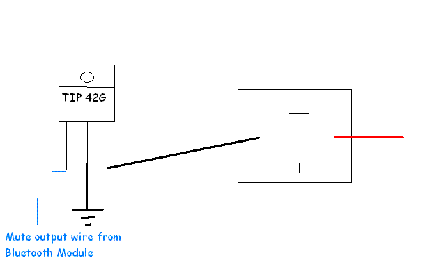

The problem is that the bluetooth module does not have enough current capacity to ground the relay. There is a simple fix for this. Purchase One of these, and connect it as follows. The ground output wire from the bluetooth module connects to the base of the transistor. With the transistor facing you so you can read the numbers, and the legs facing down, the base is the left leg. The collector which is the middle leg is to be connected to ground. The right leg is connected to the coil of the relay. The module will turn the transistor on and the transistor will provide enough current to keep the relay energized through the entire call.

motorola hf 850 bluetooth kit -- posted image.

So i would Wire it into 85 and 86 of the Relay

The drawing depicts 86 as ground and 85 as power.  Technically 85 should be ground. and 86 should have positive voltage.

I did not notice your location.  Are NTE parts available there?   NTE332  or a 2N6491 would do just as good of a job.
