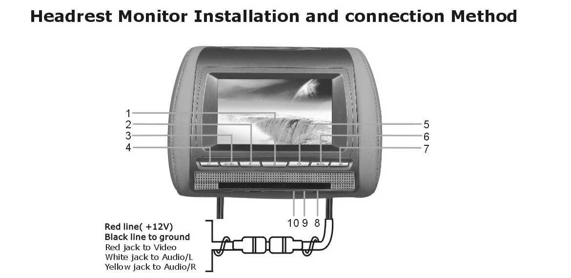

Here is the drawing from their user's manual
headrest dvd on a toyota highlander 2008 -- posted image.
The DVD does have an FM modulator that I can use. Do you know if I can get any power (12V) from under either the captain or front passenger seats ? ...or do I have to direct the wires to the dash board?

You can get the power at the driver's kick panel or at the fuse panel. Use a meter and find a wire that is switched 12 volts and ground the BLACK wire at the frame. There are plenty of spots by the kick panel that you can ground to. If your on a budget , just use the FM mod.
