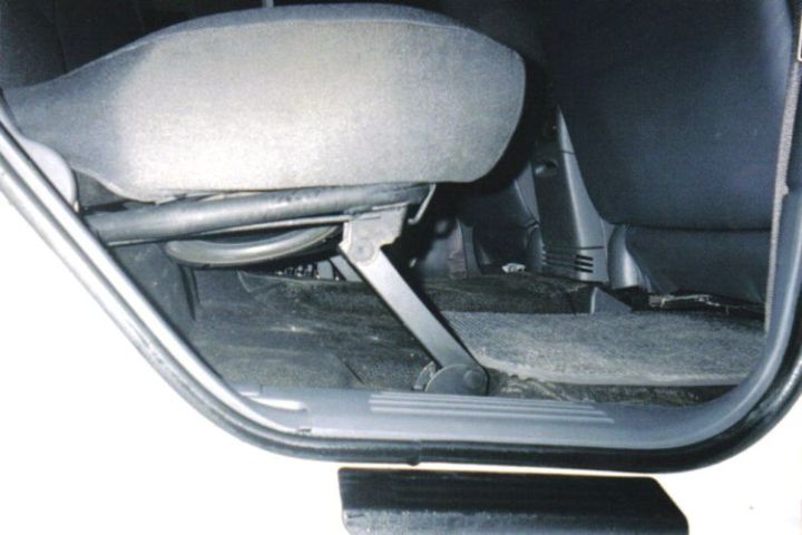

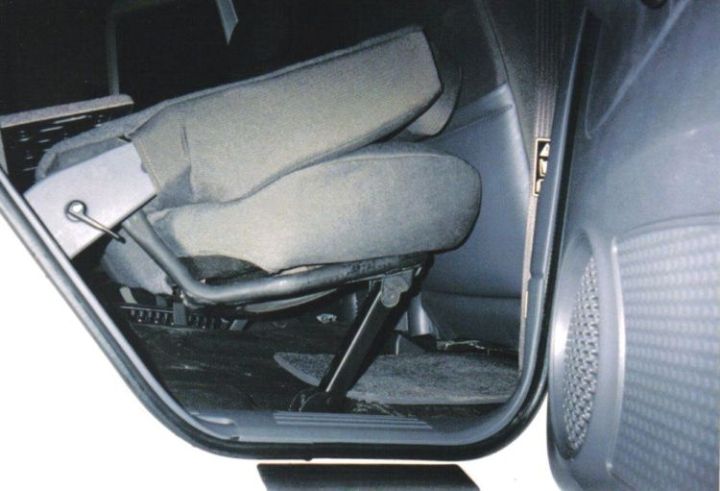

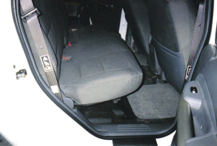

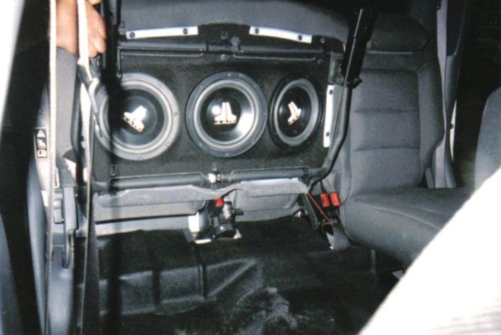

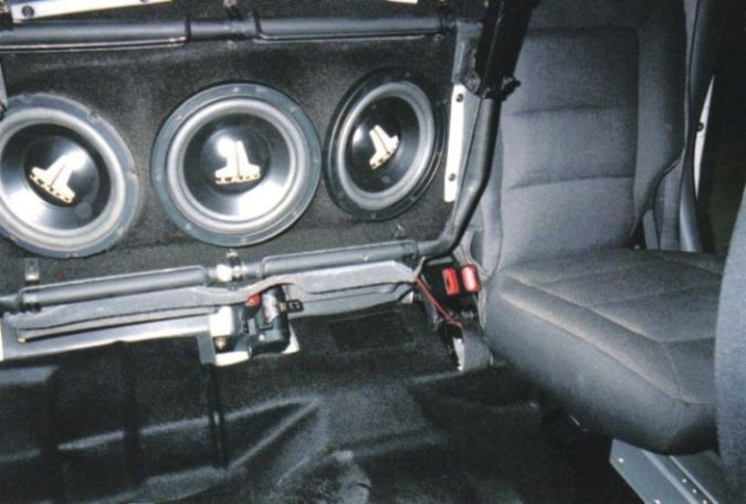

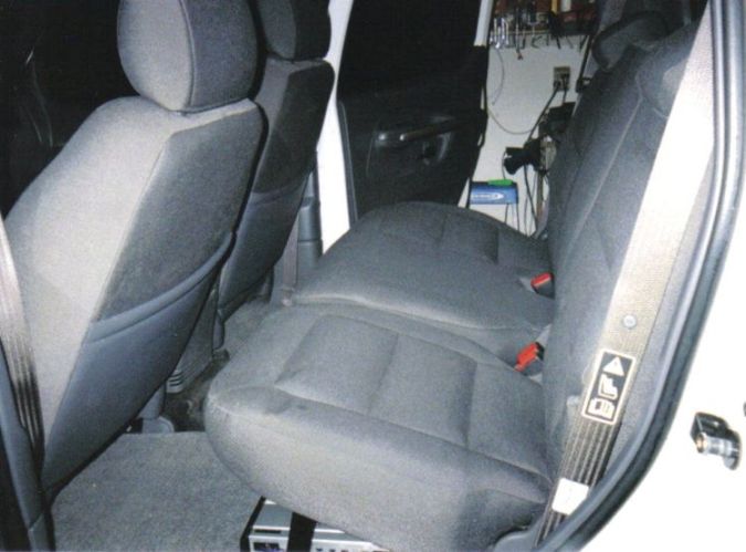

i always build my own for those vehicles because the "pre-fab" choices are crap. i always remove the rear seat bottom on the passenger side and build a hollow fiberglass one the exact same shape and size as the old seat, then pad it and put the cover from the original seat on the new one. works awesome! the sub fires down, the seat still folds forward and everything. the sub is hard to see and nobody can tell where it's at unless your sitting on the seat (which the ladies love). here are some some pics of the last one i did which was for three JL 8" subs.

No, actually, but thanks a million for the response - that's slick and I might show him the photos as an example. My skill with fiberglass is somewhat limited but I do think a similar setup might work for this application.
By chance do you remember how much airspace that enclosure had?

i dont really remember off hand but its more than it looks. ive done a few setups with it and i just adjust the airspace inside for what i need. ive put a single 10" driver in a few and they sounded great.
