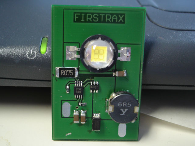

Been thinking about replacing the Acura headlights with leds but I don't want a large array. After many attempts with SEDs I think I have a winner. I think three each side should do it. If anyone is interested in the drive circuit I'll post a schematic when I get the exact values dialed in.
fun with high power leds. -- posted image.
Answers to the obvious questions:
Seoul Semiconductor P7 led

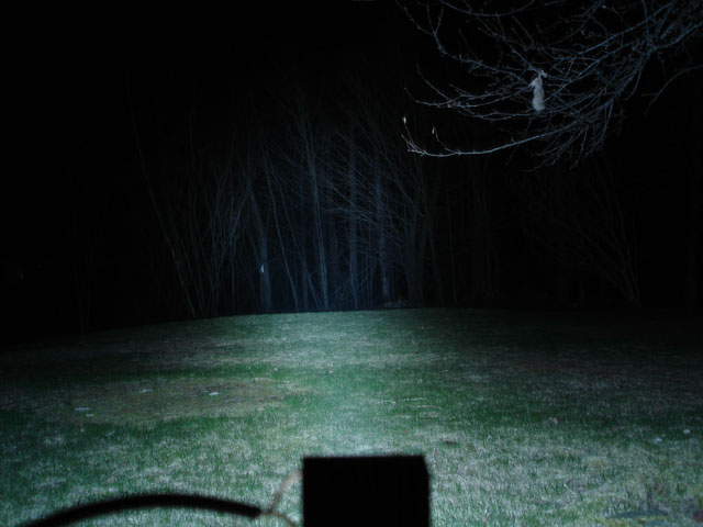

I'm working on REV.B right now. This one is going to slay.

WOW, that is awesome! They sure do look powerful enough...can't wait for your diagram.

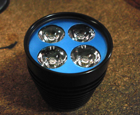

By the numbers its 10 square inches of heatsink surface area per watt.
I machined a small heat sink for 4 leds that will have machine oil circulated through it to a small remote radiator.
