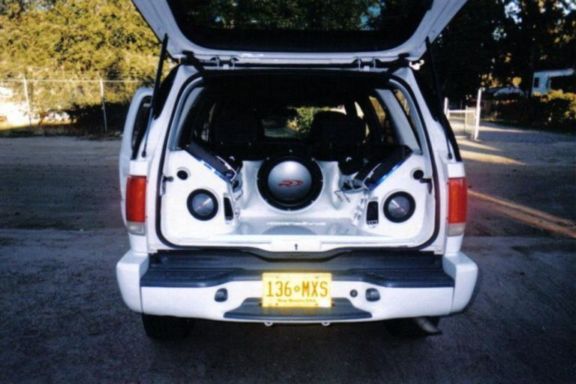

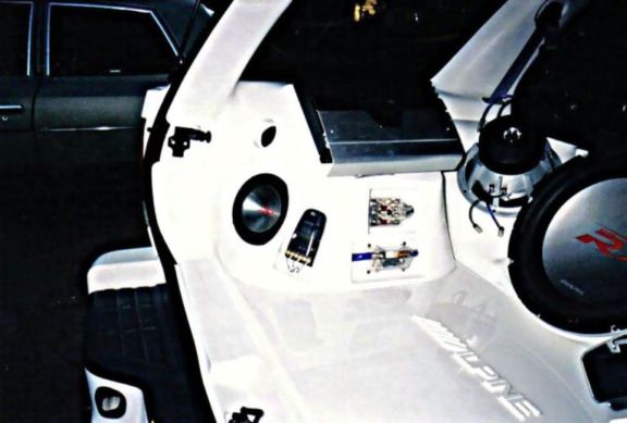

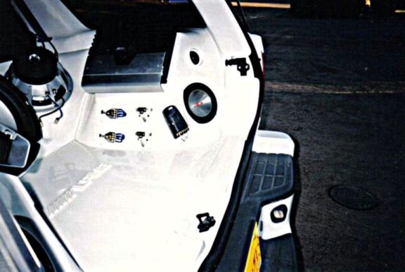

sounds like alot of work. (and if i was doing that much work i would not even think twice about running the new wire for the "bling factor", i would just do it as long as the customer wanted to pay for it. in fact, i would try and talk them into it) if i was doing the install, i as the installer would insist on showing the crossovers. maybe not as extravagant as this system i did but i would do something for sure.

Platinum - Posts: 13,725
Posted: April 15, 2009 at 9:23 PM / IP Logged
He is the customer.   The reason I asked about the location, and the amount of speakers was to find out if there were enough wires going into the door.
