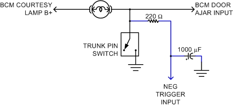

The BCM is probably triggering the security system.
Installing the resistor and capacitor network as shown in the attached diagram should solve your problem.
01 regal door trigger -- posted image.

update on the regal,I cut the door and trunk trigger wires at the bcm and installed diodes with the cat facing the alarm and connected the alarm (-)trigger wire to the cat side of the diodes.after 20 minutes the little lights on the bottom of the rear view mirror came on for a second then went off,the alarm didn't trigger.I am assuming that was the pulse that was triggering the alarm every twenty minutes.I never seen that before.
