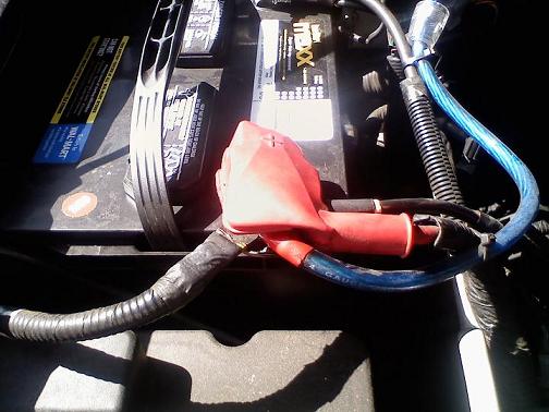

The first connect showing is from my battery (+)
are my connections good for big 3 -- posted image.

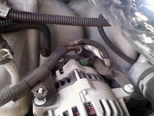

To Altenator (+)

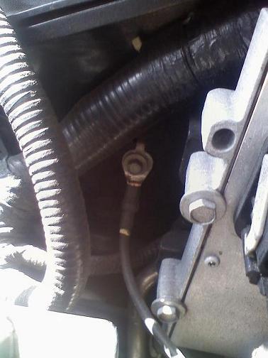

From Engine Block Ground (Between the 2 black tubes)

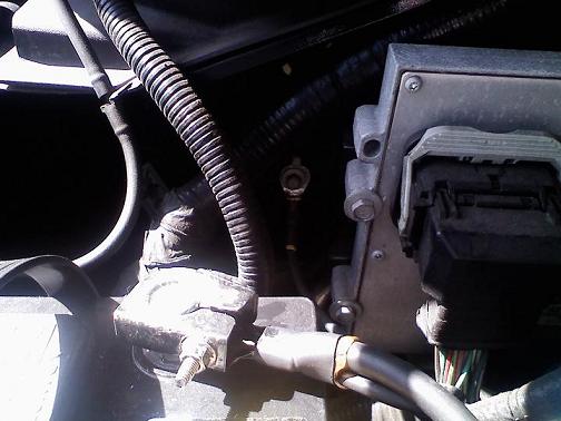

to Firewall
And from Fire wall to Battery (-) (appx. 9 inches Inches away from the battery (-) terminal as shown below)
My main question is, is the engine block to the Firewall Okay? Im not sure if this is considered a chassy I was never big on maintenence
And is that Engine Block ground Accurate enough (Picture 3)?
Also How do I get that cap off of the Alt (+)? It doesn't seem to budge.

Yeah those connections are PERFECT since we can't even see the battery and alternator connections...check the voltage and resistance of each location...you'll know if its a good connections or not.

It should be as close to 0 as possible in resistance. Locations can only be good if metered with a DMM.

Sometimes factory grounds are not that great. That is why we're telling you to use a meter to determine if the locations that you chose are good. We can't tell this from pictures that you posted. Routing the wires under, over or around the engine is irrevelant in this case, just make sure that the resistance is as close to 0 as possible,regardless of location.

Don't ground to the firewall.
Why? Besides a small ground strap from the engine, how many other grounds have you seen on a car's firewill?  None?  Just what I thought.  I've been an auto mechanic for about as long as I've messed with car audio (not full time, but have worked in several shops over the years) and I've never seen anything grounded to the firewall.  The engine block is always grounded to the frame.  Why?  Because the body sits on rubber dampers that you can't see.  And so does the engine, in the rubber mounts.  The battery is always grounded to the engine, but the engine needs to always be grounded to the frame or you'll just be defeating the point.  If you did this, you would actually end up grounding the battery to the firewall too, because if it's not grounded to the engine and the engine is not grounded to the frame, you'll get a lose ground.  It IS okay to ground something to the firewall, but I just wouldn't make it the battery OR the engine unless you also have a ground strap/cable going to the frame.
I'm not claiming to be a car audio expert, but I can honestly say I've been involved in auto mechanics since I was a teen.  So I'm much more familiar with ground under the hood than many other car audio related questions or topics.
