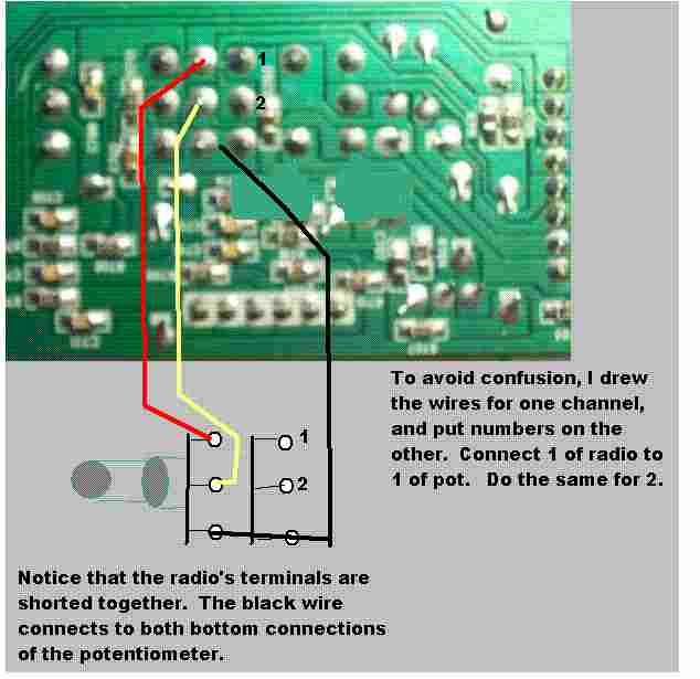

Can you take a photo of the bottom of the board.  Take it square with the board.    The power switch is the one with only 2 connections.  All of the audio adjustments have 3 connections.   I am pretty sure that the 2 sets of 3 connections directly toward the front of the control from the power connection is the left and right volume.  The picture will help me confirm this.

While I went ahead and posted the pic you requested to the end of that same album, given what you said I verified that the '2 connections' are off/on, and the next set of 3 (to the right in the pic) are the volume. But I am confused about the reading on those three. (Lets label them 1,2, and 3, top to bottom). When I check resistance between 2 and 3 it ranges from 4.5 ohms to 15.65k ohms. When I check between 1 and 2 its almost constant at 2.2 ohms. Does that make sense to you? Also, when shopping for a pot, what should I ask for?

Volume is on the other side of the power switch, there are 2 for volume, one set for left and the other set for right. Off/On is correct. Volume are the 2 sets to left of on off.
Radio shack sells a 100K ohm stereo potentiometer, only problem is there is no on/off switch. They do sell a pot with on/off, only problem there is it is only one channel. 271-1732 is the part number for the stereo pot.
Notice the 2 bottom connections of the 2 sets of connections are connected together. That is the ground connection. The connections directly above the jumped ones are the wiper of the pot. That is output of the pot. The top connections are left and right signal.

Do you understand parallel and series wiring configurations? I will draw you a picture tonight. All you need to do is parallel the new pot with the volume section of the old one. Same with the power. You will have to leave the volume level on the actual radio volume control set to a pretty high volume level, Either on/off will turn radio on. They will both have to be off to turn the radio off. Either volume control will adjust the volume level of the radio up to the volume level set on the other volume control.

Did you get a 271-1732 from Radio Shack?  If so take a pic or it with the shaft facing left and the 6 connections facing the camera.  I will use the 2 pictures and run wires between them.

You should use shielded cable to do this. The black wire is the shield of the cable. Radio Shack sells a suitable cable.
Connect both shields to the radio and to both bottom connections of the potentiometer.
