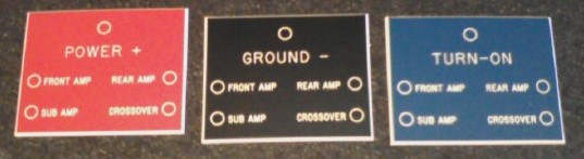

This is something someone asked me today if I think I'm going to have a problem with.  Since my amps are not in just yet, I'm not sure.  But in the past, I have not seemed to run into this issue.  Something I learned many years ago is the importance of running your head unit's turn-on lead into a relay if turning on more than one component (amp, crossover, etc), which I've done for several years. However, this go-round I'm running 3 amps and a crossover. My "goofy, unheard of" plan this time is to run my head unit's turn-on lead to the usual relay, but this time I'm going to run the relay to a distribution block. From the distribution block, each of the 4 wires will power a seperate component on the amp rack: each of 3 amps plus crossover.  I don't doubt that this configuration will be a success, but what I'm wondering is if I will get that turn-on/turn-off thump.  I'm hoping not.  As mentioned, I've never had it in pass systems, and even had 3 amps in other cars plus in underdash passive EQ.  I'm hoping that my current configuration will help to avoid the turn-on thump.  If not, oh well.  I'll be happy to get the desired effect out of my "wierd" idea: to not burn out my deck's turn-on circuit by powering up 4 items when I power it up.  I know this problem will be solved, but now you folks have me worried about thump.  Someone else got me wondering too.  Now I guess all I can do is find out.
Do some configurations produce that famous thump?  Or is it caused more by connections or improper installations?
Will let you all know.  And believe me, I'm getting real close to putting the amp rack in and hooking it all up!  Just finishing up the last-minute wiring on it, then will lay it in the trunk and hook up the speaker cables and RCA and power/grounds, etc.
I had these plaques made and will (maybe) mount them next to each distribution block, if not on the underside of the trunk lid.  More for looks and to make myself cool.
