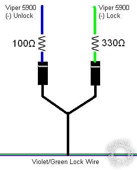

Hello everyone. I am having problems with the bypass in my car. I have a 2006 charger with a Viper 5900. The bypass I am using is a CHDL7-PK2. The immobilizer bypass feature is working fine, but the data controlled features (ie. locks and trunk pop) are not. I was just going to direct wire these functions to the car using resistors like it should be done. My question is if this is how I am supposed to wire the door locks?
06 charger, viper 5900 -- posted image.
Thank you in advance for your responses guys, and I apologize if the question is stupid.
