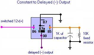

delayed turn on relay -- posted image.
I have a Pioneer in-dash dvd player that has to not "see" ground then "see" it in order to play movies. My question is if I have the relay set up correctly and also what size capacitor I would need to acheive a 5 and 10 second delay.

Bypassing the safeties isn't a subject that is typically discussed around here.

The DVD player is installed in a show vehicle, I'm bypassing the safety so I don't have to sit there and flip a switch everytime the vehicle is turned on.

I dont care about the safety part. My main concern is getting the right size capacitor to change the delay time.
Posted: May 31, 2009 at 11:43 AM / IP Logged
So connect the parking brake wire directly to ground, everyone does that here anyway, with the owner's signed agreement.

I can't... the player has to not "see" ground then "see" it before it will play. Simply grounding the wire will not work.
