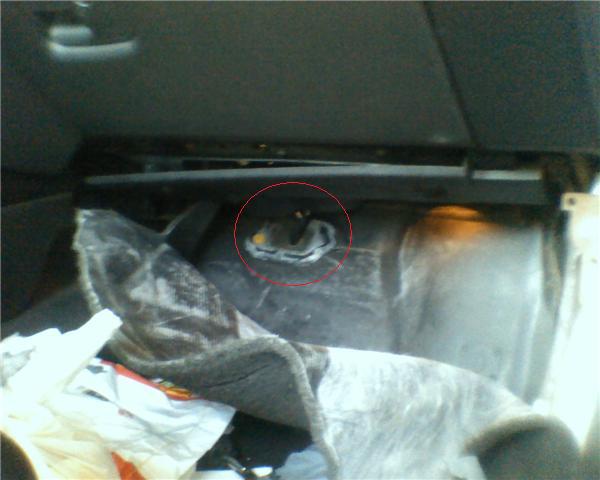

tommy... wrote:
You found a spot for power wire...Please post for others...
i believe this would be the easiest spot to run
power wire through, it's a huge square on either side of the firewall, you could easily fit 0ga without having to cut anything.  all you'd have to do is run the wire down the firewall and get underneat to push it through to the other side, i don't own jackstands so i can't take a picture of the grommit outside of the car.  but it's literally just a square towards the bottom of the firewall.
where to run power wire through firewall? -- posted image.
i'm not a professional by any means, but THAT is where my power wire is going until someone tells me i'm wrong.

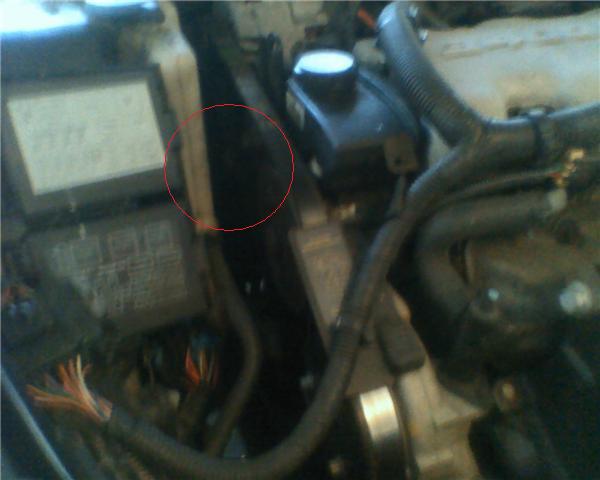

the grommit is somewhere down in this area.   remember that it's at the very bottom of the firewall, you'll miss it if you're not paying attention.  but it's seriously just an empty square down there.
