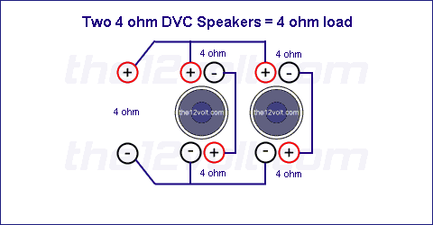

 Im trying to wire up (6) memphis 15's they are all dual 4 ohm voice coils and am tring to keep a 1 to 2 ohm load off the 6? any advice???

Do this twice, in parallel, for a net 3-ohm load.
wiring 6 subs -- posted image.

Or, to get you to the target between 1 and 2 ohms,
Do that three times, wire all three sets in parallel, for a 1.33 ohm load. (or, "an off number"... Let's see who catches that jab...)

It is true.  Everything is an off number for this group of subs, but if you can live with that it should be okay.  Use the 1.33 ohm configuration only if your amp is rated down to 1 ohm ...which is an off number, too, by the way.
