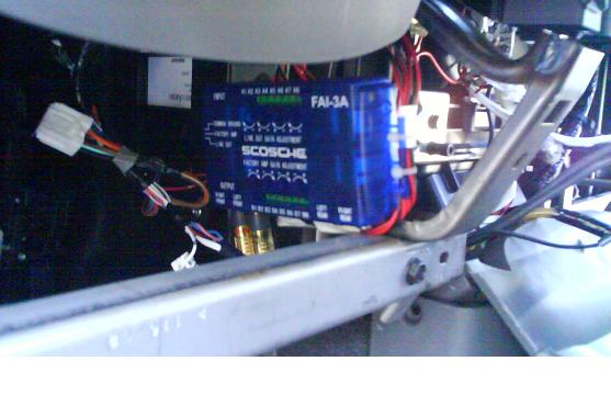

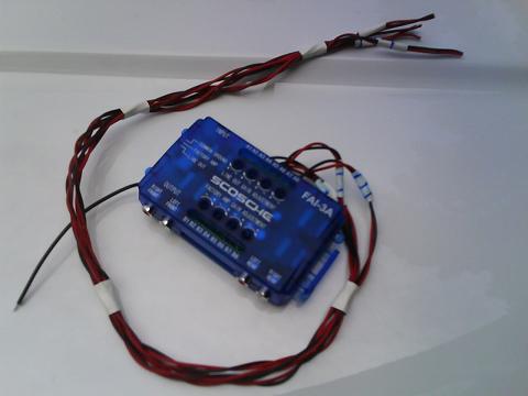

One to grow on.....A adjustable line converter can fit somewhere in most dashes. Attach some short leads to the converter and pickup your signal right off the deck. Leave enough slack on rca so if you ever upgrade source, your already linked to amp. Use converter/gain setting

Did you use a Line Out converter, or did you just connect the speaker wires to a patch cord. If you connected speaker wires to a patch cord, you REALLY need to look into a Line Out Converter.

for the line outlet converter i used, i had located right behind the subs in my trunk. and i had spliced wires for additional speakers already, but i just twisted all the wires that were attached to the converter, to the, already spliced wires. they arent covered or anything, just bare wires twisted together, i sorta was in a hurry :-/ but one other thing, is that one of my two subs cuts in and out, i tinkered with the wires attached to the clip thingies (dont know what they are called) they sit in the hole in a box to hold the wires from the amp to give subs power. i wiggled the wires and the sub cut in and out. so i thought the wires from inside the box attached to the sub were loose, so i switched the L and R wires to the opposite subs, and the other sub started cutting out, so i switched out my amp to the old 1000 watt, and it did the same thing, im so lost with it, but the ONLY thing i could think of is the size wire i had, in my haste, i bought a set of 12 gauge wire for one sub and the 16 gauge wire for the other sub, (came in the install kit with power and ground wires for amp + speaker wire) and i considered getting the same sized anyways since one sub hits before the other now.... :-/

move your converter to speaker wires behind the radio.

and the line outlet converter was schonse or whatever, sorry i dont remember lol. same namebrand as the wiring kit, i only wired in the converter kit in the trunk because of existing wires i had before. and to save time without disassembling the dash, i do know how, just a hastle lol :D  i know the wiring in the subs through the box is okay, ive had the subs and box for quite some time. they're wore out and im going to replace once i get this amp set up correctly.
