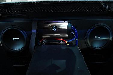

Interior panels are custom painted house of kolor tangelo , door panels are custom painted slate grey /tangelo with a marbilized effect.
Audio set up: tang band 3" neodyum drivers in dash 40 watts rms (stereo),Mb quart 6.5 components set in door 140 watts rms per side (stereo) both powered by kenwood 500x4 amp under seat.
2 12" re audio sr 300watts rms per side powered by a memphis 500 watt rms class d monoblock ran at svc @2ohms.
4 Gauge monster cable ,12 gauge monster cable
I had a ton of fun bulding this , every aspect from the sub box to the custom paint I did on my own,thanks for every body who helped out with advice on this forum along the way.

Any comments or suggestions are ok. I already know that mounting the amp on the box is a bad idea but a put 2 layers of dynamat behind in between for vibration and to give the fan some room, it help out alot.Also the cap is just for look ,it is my distribution point for my amps.
