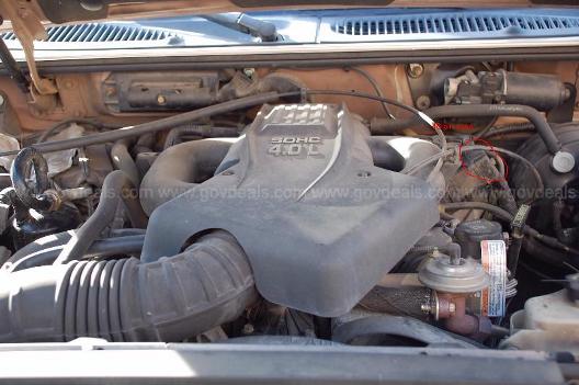

Anyway,  here are a couple of things in case someone is doing something similar.  For the tach wire, I thought it would be hard to tap into the 48 pin on the PCM.  That area is tight.  I tried several wires on the coil and injectors, but the unit would not tach sense with them.  It may have been user error, but i just could not get it to work.  So I found someone who says the wire is accessible on a 48-pin(?) square connector on the top of the engine.  I opened the protective plastic cap on the only big connector on top of the engine, found the tan / YELLOW wire, and tapped into it there.  Worked first time.  here's a pic

another try with the pic of the location of the 48-pin connector for the tach wire.  you can kinda see it int he red circle.
compustar p1bam s and pats bypass -- posted image.
