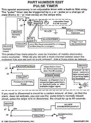

I have a 2000 Jaguar S-type that was converted from halogen to HID factory assemblies/ballast/etc. Everything works good, but i would like to introduce a delay of a few seconds prior to the ballast igniting.
I have read posts for the DEI 528T, but can't come to grips with what is being posted in relation to my application. There is a relay for each headlight assembly that takes a negative trigger from the headlight switch and turns it into a 12volt positive. Can anyone illustrate exactly what wire for the 528T goes to what on the relays?

528t_pulse_timer.pdf

dei 528t jaguar hid relay -- posted image.

Posted: July 15, 2009 at 1:47 AM / IP Logged
John, on that diagramme you nicely showed, wish I could do that, surely it's cut blue loop for NEG pulse? Yours, H.

To tell the truth I have never seen one of these timers.
Looks like I made a mistake.
I remade the Diagram from the one page instructions I have.

Posted: July 16, 2009 at 1:24 AM / IP Logged
Honestly wasn't having a pop, you're normally so precise.

Posted: July 16, 2009 at 8:30 AM / IP Logged
It was a little confusing it was not the best wording
"Cut =  Trigger Upon Negitive Going Away"
What Idiot would print that?
