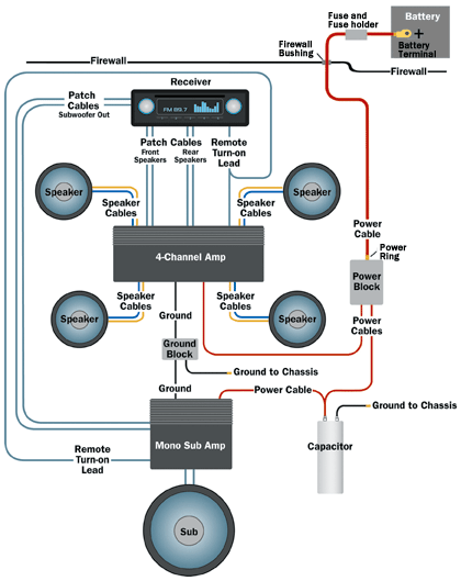

imupabove
Copper - Posts: 369
Joined: March 14, 2009
Posted: July 14, 2009 at 2:12 AM / IP Logged
is this is good way to set it up?
Rockford Punch 240x4 - Last Post -- posted image.
