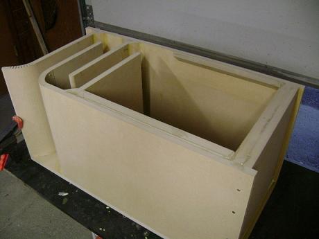

If Im reading your dimensions right   are you intending to have 1/3-ft3' of unvented interior space? Peep what the canadians box looks like:
labyrinth porting -- posted image.

That is where I got the idea from. I plan on giving the driver 4ft^3 , I then figured the port and came up w/another 1.62, and added .3 for driver/brace displacement for a gross of around 6. My port isn't as long tho. I have only two chambers of port  4 1/2" apart.
