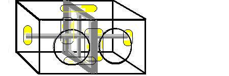

Here are the stress points that braces have to control:
ok, ok, box designing it is. -- posted image.
It's sort of self explanatory.  The center of any expanse of baffle is the weakest point and so is subject to the most flexing.  There have been space-saving braces used and talked about on this forum:  metal threaded rods, wooden dowels, pieces of leftover MDF....

For bracing, stevdart was right about where to brace. I always use extra MDF but I think a wooden dowell would work well too. I don't really like the steel rods but bracing is bracing and in the end it is always better to have some rather then none.
The only thing that I suggest is making sure that your braces will not flex. I see too many times where people spend a lot of time on bracing to not have it help a lot. To me, if you add a brace piece that is going to flex badly you are not doing much by adding the brace in the first place. The point of bracing is to prevent a loss of energy from the material flexing. If you fix the wall from flexing but now the brace flexes then you are not any better off IMO. So just make sure any bracing is sturdy and does not flex at all.
