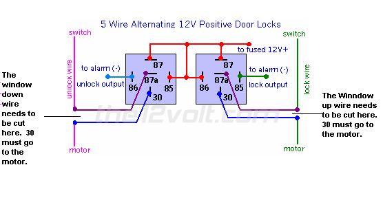

What kind of voltage do you get on the 2 wires that go to the motor.  Not pressing any buttons.  Just what is the voltage on both wires?  Black lead on ground, red lead to one wire, then move red lead to the other wire.   Are you familiar with 5 wire door lock setups?

This time set your meter to the Ohms selection, and do the same thing again.  Black lead on ground, red lead to each of the 2 motor wires.  Give me the meter reading of each wire.
When you tried the 5 wire setup, did you cut the motor wires?
97 chevy k1500 astra 1000rs window prob. -- posted image.

Well what happend with the motor wires, when it went up the blue had 11.3 volts, when it was going down the brown had 11.3 volts.  When there was nothing it was at 0 volts.
I ohmed out both driver and passenger side, both at 200.  The driver side had .8 and the passenger side was at .3.
Thats the diagram I was using, but everytime i would hook up the constant 12 volt It would pop the fuse.   I thought I should be using a different diagram cause that setup was calling for 2 neg inputs (1 for lock/1 for unlock).  It just seems that everytime it has the 12 volt constant going into the switch it will pop the fuse.
I am just lost on this!! i really appreciate the help your giving me!
