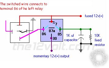

witht he constant to momentary relay diagram when the relay turns off will the output wire become a ground i would assume so but I figured I would ask before i tryed it

hey I need a bit of help guys i buildt the relay as shown however it doesn't turn off i left it hooked up for a good 10min and it stays on any advice would be great

No, the relay does not supply ground on terminal 30 (output wire).  Are you using a polarized capacitor? If so, what size?

yes it is a polarized cap it is 1000uf 35vdc

Please double check all of  your connections.
30 is the output wire that provides a momentary 12V+ immediately after terminal 86 is connected to 12V+ through a switch (Accessory, Ignition, etc.). Terminal 87 goes to a constant 12V+ source (battery). Terminal 85 is connected to a polarized capacitor and resistor wired in parallel that are each connected to ground as shown in my diagram. Terminal 87a is not used. Pay close attention to the diode across the coil. The cathode side (with stripe) is toward 86. The anode side is toward 85. If necessary, bench check it before installing it in the vehicle. I've used this configuration many times and have never had an issue with it.

I have a diagram that I think will work for you.  I have not built and tested it yet.  It may take a 2200 mic capacitor.  You will have to build it and test it.  My thinking is that when the left relay is turned on, it will energize the right relay until the capacitor charges, then the right relay will disengage, that will be the piulse when the wire goes positive.  When the wire goes dead, the left relay will now place ground on terminal 86 of the right relay.  The cap wil be charged, thus powering the right relay briefly.  This will be your pulse when the wire goes dead.
In case you missed it earlier, I have not built and tested the above Idea.  You will have to test it before attempting to install it in a vehicle.
You can ditch the resistor, it will not be needed.  Test it and let me know if it works.  Changing the cap size will change the llength of the pulse.
