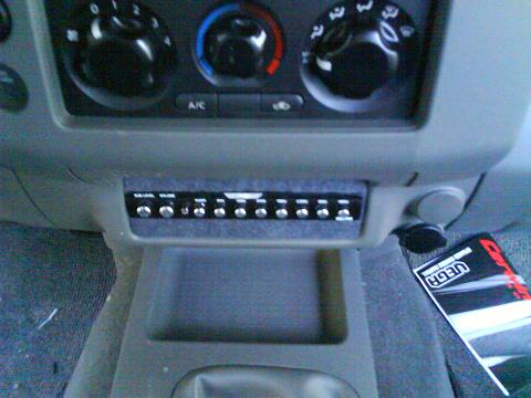

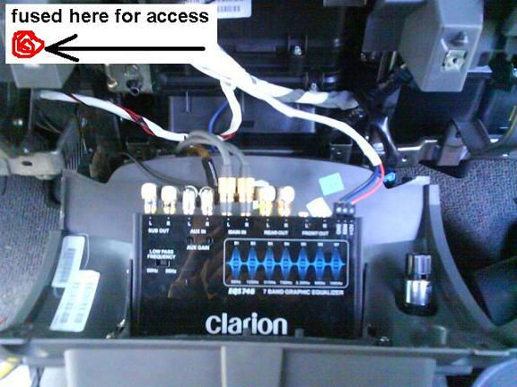

Nice choice....its pretty clean. If you have a media player, especially "anti ipod" then there's a separate input with level controls for that. Thats the reason I got it. Other than that, it takes 1 input and now Fader, Vol and sub all control from there. FUSE the 12V+, I cant remember the fuse rating though, I wanna say 2A. Maybe an idiot can figure it out. 100db s/n --JHEA!!   7V pre-out works well with the MRP.   0.005% THD dude your stoked! Here's how I put mine in.
how to a eqs746? -- posted image.
I cut plexi-glass to fit over the hole. It was a small compartment before. Then just veneered it with carpet. I used 2 layers of carpet to make it appear recessed, or somewhat flush. I'm constantly boosting 16k and cutting 315k when playing Mp3's.

"FUSE the 12V+, I cant remember the fuse rating though, I wanna say 2A"
what do you mean by this?
regarding the "main in" on the EQ; where does the other end of the RCA go to? to the deck right? but which preamp out? front, rear, or sub?
