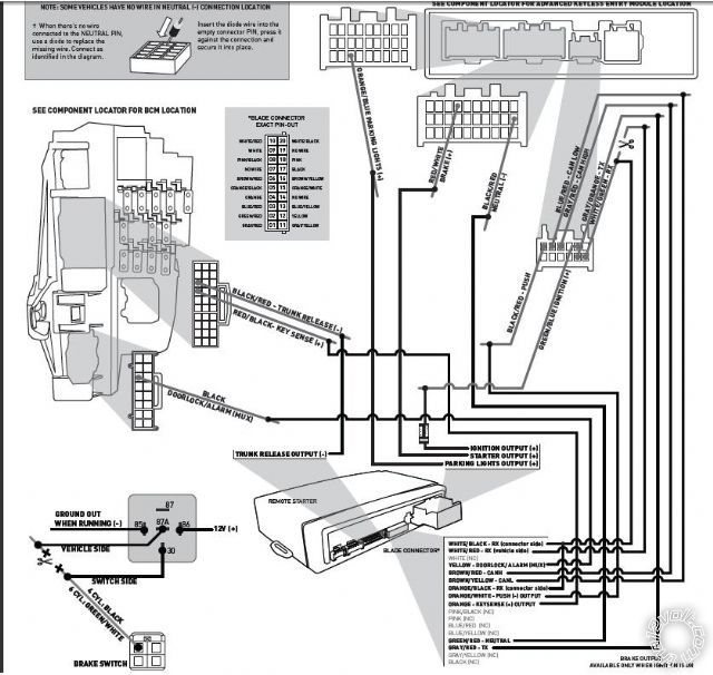

idatalinks instructions
2009 mazda 6 pushbutton start -- posted image.
