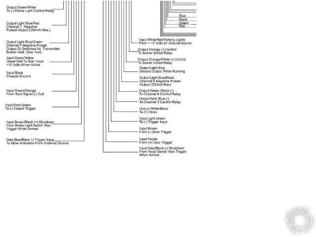

i have a honda CRV 2000 and i install a aps997a remoter starter
all my installation came out great the remote works and the doors the only thing i didt hook up is the trunk release
i was told i need a relay to open the trunk is that true or can i use the output of the alarm unit to open the trunk
will the dark green wire go to the trunk pin (blue/black) below
and the output to the trunk release
please advise  thank you
Trunk ReleaseYellow/White (+) Switch
Trunk PinBlue/Black (-) 22 Pin Factory Alarm Connector behind Driver's Kick
Dark Green Wire: (-) Instant Trigger Input
This is the instant on ground trigger input wire. This wire must be connected to the hood and trunk pin
switches previously installed.
NOTE: This wire will be shunted when remote control channel 3 is accessed, (trunk release). This wire
will remain shunted all the while there is ground present and for 5 seconds after the ground is removed.
This allows the operator to open the trunk via the remote transmitter without having to first disarm the
alarm system. See below for wiring detail.

Yes...If the output is - off off alarm/remote start (which is normal)...You need to convert it to a + output...Heres a diagram for ya...And from what i get from the info you posted...The Dk. Green wire from the unit is attached to the Blue/Black  -  trunk pin wire...Enabling you to use the trunk pop feature w/o triggering alarm...!
