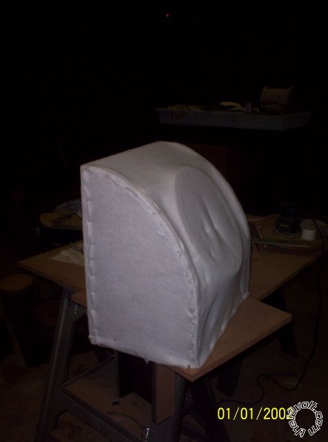

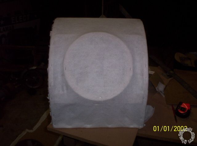

my first fiberglass box -- posted image.

dude dont glass it yet. You need to pull the sub ring out more. You dont want it to be even with the box!! also you dont need to have the fleece all around the box. If there is mdf then there is not need for it. That will create a ton of extra work. Let me know if you have already dont it. If you havent I will help you through the process so you dont have to go through so much trouble.

well the only reason i was doing it around was just to seal it off. I aint really worried about how it looks for my first one. were actually building a frame for my brothers 2 15s and gonna make the rings coming out a pretty good bit and all. i was just testing for this one. I was planning on taking the fleece off from around it before i started too
