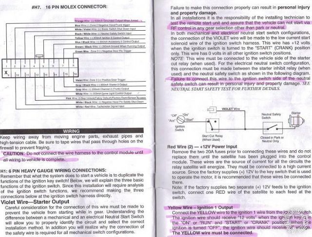

Installing an autopage 665 with PKALL in 2005 Tacoma V6. I am a beginner. have wire diagram for said truck. Not sure where or what these below are or go.
H7 16 pin from Autopage-
    Orange wire (-)500ma grounded output when armed. Where would i connect this to my truck?
    Yellow wire (-)200ma Ignition 3 output. I don't think I need this one do I?
H1 6pin from autopage-
    Brown wire-AC/Heater output(+), is this only if you have auto climate control?
Should I need any Relays or diodes with this truck and alrm/strter?

Not sure about this PINK wire out of H7 connector...
Says 200ma- programming out----2 step dr lock----Factory security disarm----or sensor bypass out??????
Posted: September 16, 2009 at 6:01 PM / IP Logged
Just saw the first post, yellow goes to ignition, pink wire dis-connects factory alarm during remote start, if you have one.  Orange GWA used for window closers etc.  Do you have climate control?  Your heater  AC and rear defogger;  if  youswitch them on while ignition is off, will they come on when you start the car or retain their settings from the previous engine run?  If so  Brown not needed.
Take a DMM set to to 20VDC, set black probe to your grounding point and red probe to each fused input, should measure 12.6volts. Also make sure (by testing as above) that the starter output is working from the R/S. How many leads coming from the ignition switch?  Are they all wired up and accounted for?  Also from your questions about the wires in the first post, one comment, RTFM autopage 665 in 2005 tacoma -- posted image.

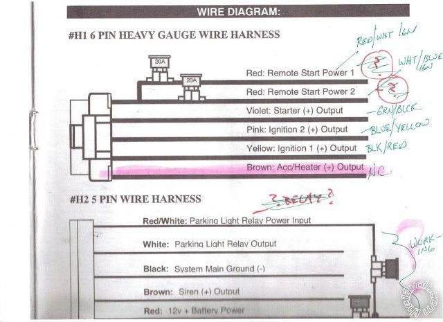

Attached pink and start diagram

This pink wire on the sheet, the truck has the normal stock alarm, do I have to bypass it?
I will attach my str wire harness form autopage...please take a lookautopage 665 in 2005 tacoma -- posted image.
Posted: September 17, 2009 at 4:48 PM / IP Logged
Add on a relay to the Violet as I showed you in a previous post.
