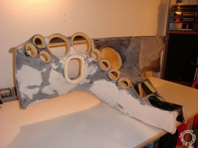

Not yet hope to have the dash primed and starting on doors will post new pics soon

Posted: January 03, 2010 at 8:07 PM / IP Logged
fiberglass interior - Page 2 -- posted image.

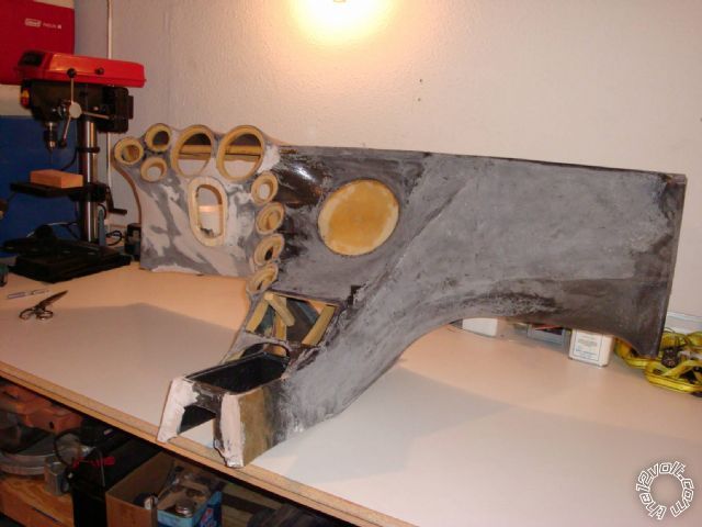

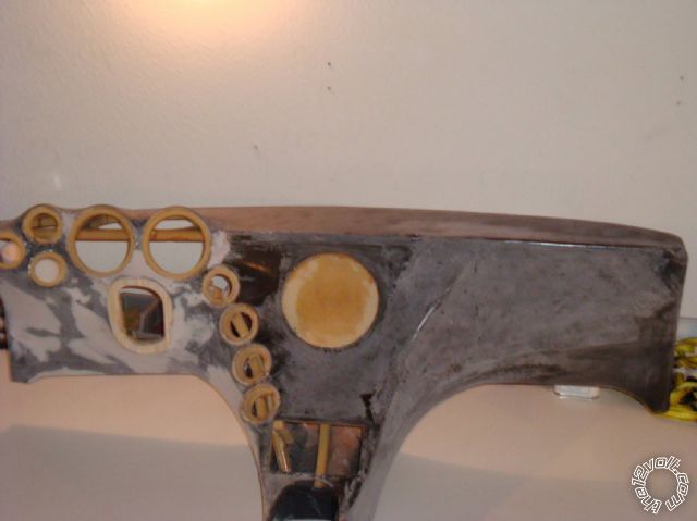

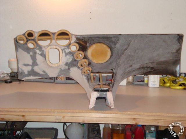

sooverworked
Member - Posts: 16
Joined: September 18, 2009
Posted: January 03, 2010 at 8:14 PM / IP Logged
Will post new pic soon how u enjoy { post comments }
