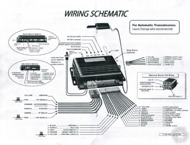

r/s check engine problem, safari 2005 -- posted image.
I have only one ignition wire on the the r/s so i have connected only the yellow from the brain to the pink on ignition harness. Should i connect the yellow from the r/s to the pink and onto the white (ignition 2) also?
This is my first installation so I am kind of learning.
also, I have disconnected only the tach wire and stop using the r/s function while I figured what is the problem.
On my wiring diagram, the yellow, red, orange, purple and red. The green (5th relay) is not used.
On the second harness, the black, purple (the one i have disconnect for the moment), grey, orange and yellow are all connected.
on the third harness, the only wire used are the grey and purple for the siren and the door sensoring
I have the ADS-TBSL-PL to bypass the security, which is working well.
Is it possible that the tach wire is disturbing the tach signal going to the PCM and make false reading of the engine rpm therefore preventing accurate speed selection for the tranny?

You need to hook up the green wire(5th relay) for your 2nd ignition.  Then you need to set your jumper on the module to ignition 2.

Ok i will try this.
Just to be sure: when i used the remote starter, the engine crank and start correctly then the starter disengaged. If i push the brakes of open the hood, engine stops. acording to this, the unit works but a check engine pops while the engine is running. So it is not related to the tach wire hooked on the white wire at the pcm?

Ok I did connect the green wire from the r/s to the brown (ignition 2) even if in my wiring diagram from autostart said it as a white wire. Tommy was right about the color. But the check engine light has pops again at the second remote start attempt. the first attempt was fine.
On Tommy   wiring diagram, he say that the tach signal comes from the white wire at the PCM. I have two white at the PCM. Could I have picked the wrong? Could it be a bad learning of the signal? I'm puzzled
Does someone knows what could it be?

If you had the wrong white wire, then the tach shouldn't have been able to program.
Ok, I thought the above wiring diagram was wrong. Here's the correct ignition wiring for that vehicle according to Directechs (which I've used on MANY GM vehicles):
12- Red, RED / white
Starter-            Yellow
Ignition-           pink
Second Ignition-    white
Accessory-          orange
Second Accessory-   brown
Make sure you at least power up both the pink and white wires. That should get rid of your check engine light problem. I've never done a remote start that didn't power up all the ignition and accessory wires though, and I recommend you do the same.

I'm still puzzled. The only white I have is in the steering column harness. In the ignition harness I have a brown which is the same gauge as the +12V, accessory, etc.. The white is in a smalller gauge, looks like a 20gauge  and the brown looks more like a 12 or 10 gauge. I did not try the white to see if there is +12V when I put the key switch at on. Also it is a Safari van. Thanks
I will look if the brown I hook the second ignition shows +12V at accessory position on key switch.

Oops, sorry about that. But the Sierra and Safari have the same wiring colors. And the Directechs I listed was an 05 Safari van.
I can't picture the Safari wiring. However I know in the Chevy/GMC trucks the ignition wires split off after leaving the steering column right behind the metal plate. It's always been a large awg white wire in that year, and I can't see it being different in the van. It might be a good idea to remove the steering shroud so you can access the wires directly out of the key cylindar. And as always, be sure to test the wires to make sure you have the correct one's.
