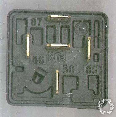

Platinum - Posts: 13,725
Posted: October 05, 2009 at 5:51 AM / IP Logged
wiring an accessory to ignition on power -- posted image.
tkpopeye
Joined: October 04, 2009
Posted: October 05, 2009 at 8:42 AM / IP Logged
Is this something that is in the truck already or do I need to purchase it separately at Radio Shack or somewhere else? Also, can you clarify the connections? The numbering makes sense but I am not sure as to the exact wiring. Would you have a schematic of this type of connection?
