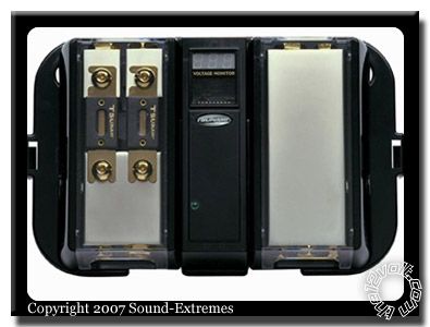

I am currently using a Tsunami Power Station which sits on top of the Optima Battery that has Power & Ground Blocks for the Amps!
Maybe if I add a second Ground Connection from the Power Station to the Chassis, It will make things better for me.
Let me know what you think about this idea... Here Are Some Pics of the setup!
This is the Power Station<BR>
no power orion amo 2400d -- posted image.

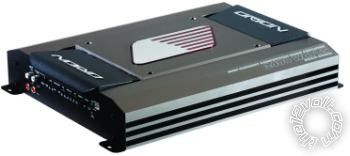

This is the Orion D2400 Amp<BR>
