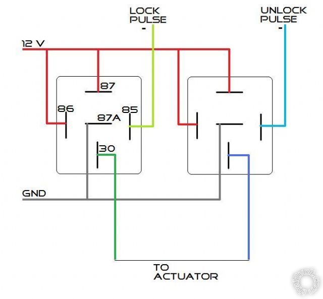

Thanks for the speedy responses. I wasn't using additional fuses, as I had the relays tapped into the keyless entry unit's 15A fused constant source.  I didn't realize there were special lock relays - I'll have to look into that.  By "disconnect the pass. side until you have only motor wires", what are you getting at? As of right now, the pass. side switch is not wired at all, and just the actuator is connected to the driver's side actuator.  I'd like to get the pass. side switch working as well, and I was figuring that once I got the relay situation squared away, I would run the ground signals from the pass. switch into them with the keyless entry outputs.
Question on the relays though - if wired like in the attached pic, how can they be grounding out if the coil isn't energized to switch from ground to positive except when the signal is sent from the keyless entry? And how did this thing totally kill the keyless entry, but things went back to normal once it was removed?keyless entry smoke -- posted image.

Are the switches driving the relays or the actuators directly?
You should be using the relays to trigger the actuators, and then use a (-) output from each switch (including the keyless) to fire the relays.

The driver's side switch is currently driving the actuators. I added the relay setup to utilize the keyless entry.  Would rewiring the switches to drive the relays and not drive the actuators directly solve the issues I'm having?
My main concern is with how the relays were somehow passing 12V to the ground wires without being energized. Also, I should add, that I bench tested the relay setup with a spare actuator and a 12V power source prior to vehicle installation, and everything ran smoothly - that's why I was surprised at the fire that started 5 minutes after install.

Sending 12v directly to the actuators, which rest at ground? Yeah, that'll cause a fire. Disconnect the switches from the actuator leads and wire them to switch the relays' 85 terminals to ground.

I only used the switch's ground input and lock/unlock outputs to send a - pulse to the relays, attached at the keyless entry pulse outputs, and everything works great.  Must have been the 12V from the switch that was running into the actuators that was burning through my ground wire.  Should have gone the 'trigger the relay route' the first time, but was too lazy to rewire the truck for that. Did it and it works great now.
