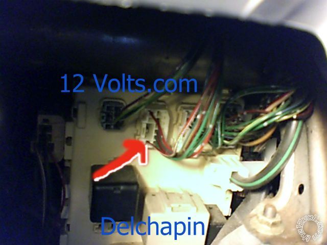

Hello
Maybe I have an easy problem, but I can not fix
I got a TOYOTA ECHO 1999-2000.
I can not disassemble the front panel to make the respective INSTALLATION
comes all in one piece
any help is good
Thanks

Undo the steering column cowling to get at the wiring.

that looks easy, I wanted to disarm all
like the others.
Where can I find the PIN of the 4 doors, safer or Easy?
(No electric system brings with it doors Manual)

In alot of the new gen toyotas i come across, when the dash piece is all in one like that, you would normally find most of the wires you would need behind the pasenger glove compartment! It's where i go! I do entire alarms and starters without even working on the driver side! Makes the install alot safer to!

All door pin are in the driver's kick panel at the harness going to the rear.  The color RED / white (-).....

Thanks to all
Solved the QUESTIONS
PIN 2 Photos of the doors
Red and White (-) Safe and Easy

Also on most modern Toyotas there's room behind or to the side of the glove box or adjacent to the head unit to mount the alarm module.

Yes, thank you was not as open, but stay well all readily accessible the same for the speaker to the front well hidden. this will help those who arrive in the future here.
