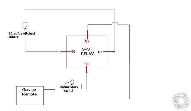

I'm thinking a SPST relay.
Left side of momentary switch goes to remote, right side of momentary switch goes to common (30) on SPST relay.
Coil is wired to 12 volt switched source.  Bike off, hit the switch, nothing happens.
Pin 87 on SPST relay goes to other side of garage door remote to complete the circuit.  When bike is on, relay is energized.  Push momentary button and it completes the circuit from pin 30 to pin 87.
I think we have a winner.

Will the diagram I posted above work?  I know it's a crude non-engineered drawing but you get the idea.

Yes, it will work.

Thanks.  Would you say in your opinion that's a pretty easy solution?  I didn't know if there was a better / easier way to go about it but this seems pretty straight forward for what I'm after.

You're welcome. Yes, it's an easy solution.
In my opinion there is a better way with the same amount of time and work involved, but it basically comes down to personal preference. When I added the garage door opener to my bike, there were two things I didn't want to do... add a button and have to change batteries. You can power your 6 volt remote and use your high beam switch to activate the remote.
