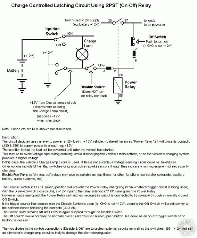

oldspark
Gold - Posts: 4,913
Joined: November 03, 2008
Posted: November 29, 2009 at 6:13 PM / IP Logged
How's this as a systems diagram? (schematic etc)
It may have errors, and it isn't quite a wiring diagram though enough info should be presented for the semi-experienced.
And it has its own ramble....
using relays for auto on solutions - Page 2 -- posted image.
