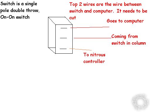

I need some help. I lost my diagram I used to have. What I am trying to do is. I have a momentery switch for my orverdrive button on my car. I wanna be able to turn my overdrive off then hit a switch and be able to use the button for my nitrous.

Do you know if the other wire of the switch is connected to power or ground?  Do you know were the switched wire connects to the computer?

I forgot about that. I am pretty sure its a hot. Not sure where the wire connects to the computer. But the last time I did it, I did all the connections in the column.

If you know where the wires are in the column, that will be fine.   Give me a minute, I will draw you a picture.
relay -- posted image.
