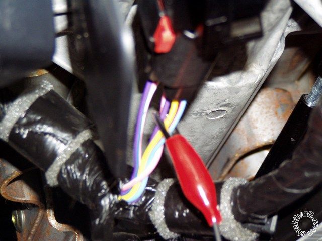

Where is the best place to grab the ignition wires. I looked in the column and the wire colors didn't match any diagrams I have. I have an Audiovox one, Direct wire, and the on off this site there all the same. Where I looked, Key cylinder is on the right side of the column and it connects to the ignition switch on the left. I found Starter 1, Ignition 1, and I think acc. I can't find the key sense wire or the second starter wire. I will be using PKUMUX since the owner has an all in one keyfob/ignition key. Should be an easy install it was my 6th car today and we didn't have the bypass in stock so I will be doing it next Saturday. Was hoping to get the starter in but I gave up and called it a night.

key sense wire and second starter are the same PURPLE / brown at the ignition harness
Platinum - Posts: 7,828
Posted: December 06, 2009 at 8:20 PM / IP Logged
I believe they are the same as the 2006 Dodge Caravan.  I got the wires in the steering column.  You only need 3 wires.
Starter   (+)                    Yellow
Ignition 1  (+)                 Pink/White
Starter 2   (aka MUX)   PURPLE / Brown
06 town and country ignition wire loc -- posted image.
All listings I have show Keysense as NA.
