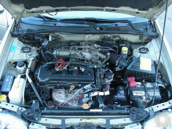

Thank you T&T. Ok, you said the locks/doorlocks run to the door, but where did you splice into the door lock and unlock wires at?  Which way did you route the tach wire to get into the engine bay ?
2000 nissian sentra remote start - Page 2 -- posted image.
There are 4 ignition coils there, I have one of the wires circled, would that be a good place to 'splice' into it ?

On the left side of your picture, just behind the wheel arch, that harness leads into the interior passenger side, slit the grommet there, and feed your wires through!
I'm not sure if i read you picture properly, but your'e not splicing any wires at the four spark plug connections, just behind there is where the four injectors are, you will locate the wire there, you can use any wire that is NOT COMMON at the injectors, i believe the common wire is RED / black, dunno if memory serves right there!
The door locks run in the harness going into the door, this will be just under the bottom of the interior fusebox, the harness is secured to the base of the fusebox holder with a strap to the body, open this harness and test, they rest at four volts or so!
From looking at that engine, looks pretty much the same to me!
