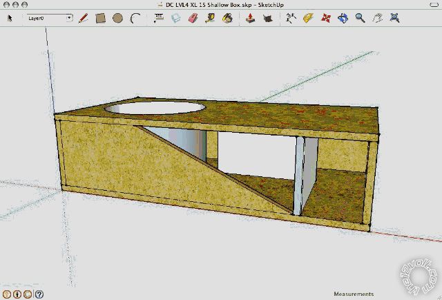

Ok Well I was originally going to go with a 12 but now im leaning toward the 15. Below is a sketchup rendering of the box tuned to 35Hz. The overall size is 38W x 10H x 20D Which gave me a net volume of about 3 FT^3. The Port is 6.25W x 8.5H giving me enough port area given 16 IN^2 per 1 cubic foot. The front is cutout so you can see the port inside.

Its late now So i cant call, but i would send DC an email asking there recommendation for port area per cubic foot. That port area seems to be too small to me.
