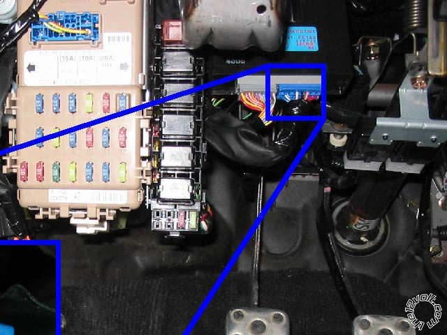

HI does any one know what is the best way to hook up a rear defroster on a 2005 Impreza

it is a blue wire at the BCM blue connector pin 10 and it is a negative latch
anyway that what my software says
subaru impreza rear defroster 2005 -- posted image.

I am interested in this same connection for my 07 STI. Is it only the blue wire that needs to be connected? Do I need to isolate it or anything else? I thought on these cars the relay was the blue connector on the top part of the fuse panel???
