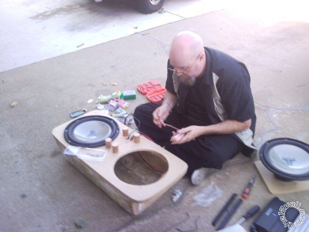

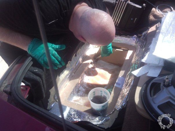

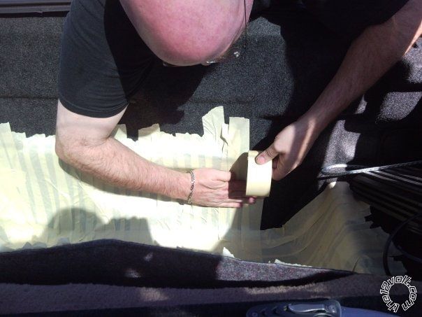

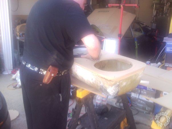

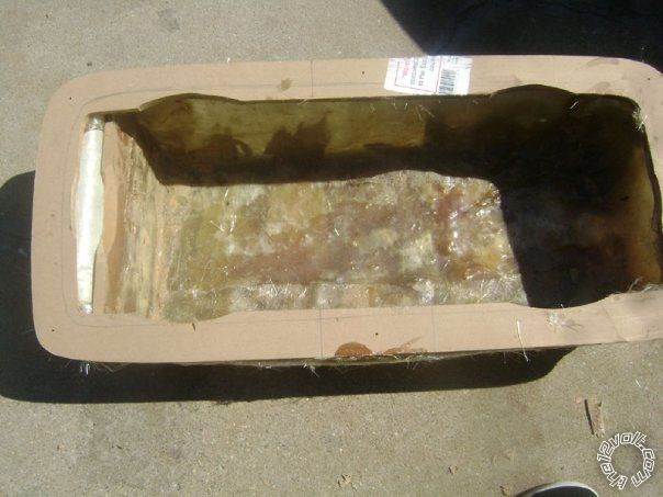

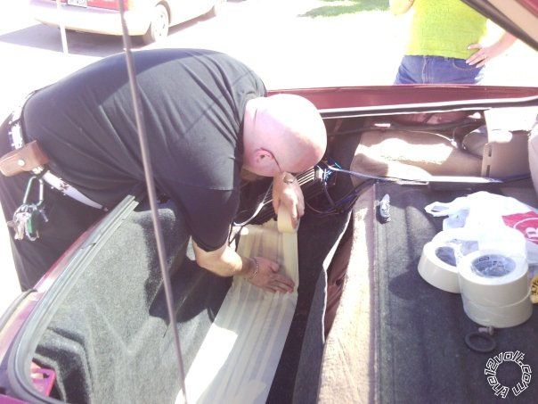

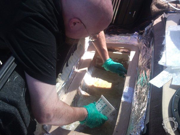

Thought I'd post some pix of a woofer box I built for a camero my friend just bought.....
recent fun -- posted image.

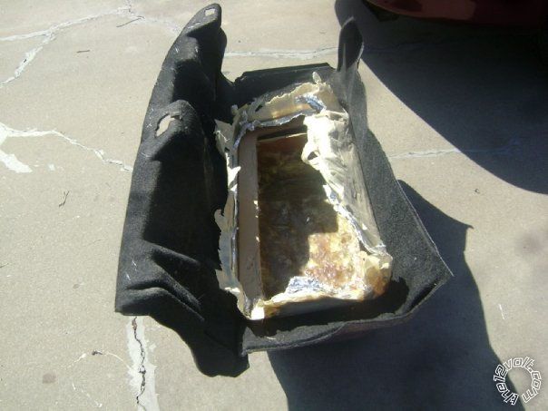

It took me 20 minute to seperate the box from the capet...LOL

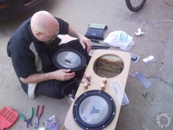

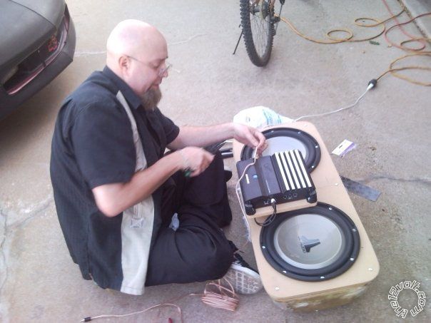

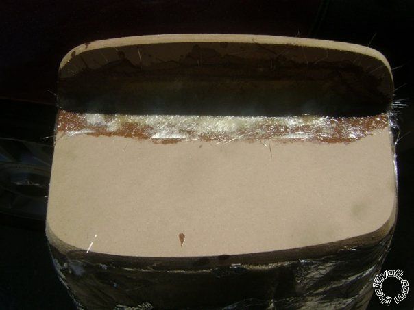

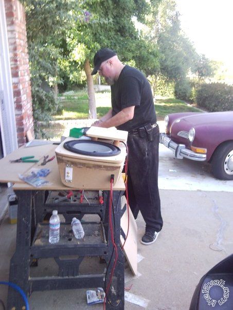

I put this flat end in so I could mount plugs for the RCA's and Amp power and ground. This way if he needs to pull the box for extra storage he just lifts the box out unplugs without leaveing any exposed power lines.
Here are the plugs installed
The four pedistals were there for the amp stand that "floats" about two inches above the speakers. You lift the whole box out buy grabbing on to the amp pedistal and setting it on the trunk. then you unpluge the box and it's out! easy as pei....HeHeHe. The pedistal will soon be made out of plexiglass and lit with a couple of blue L.E.D.'s for a little flash and the speaker grills drops down over the whole thing...pix soon to come...
Whatcha think...

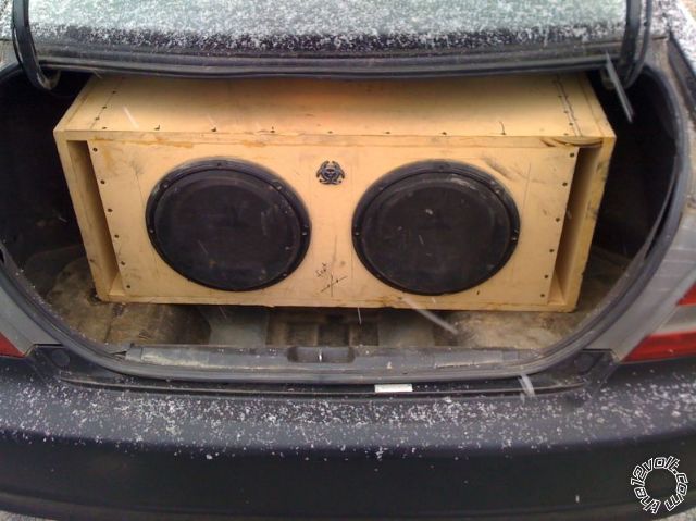

I have two of those subs in a 5.5 cu box! ported JL spec's guess it's tuned to 25 hz seem's a little low to me but maybe just good for sound
I'm partial to ported box's though sealed never seem's loud enough, tight though for sure.....
