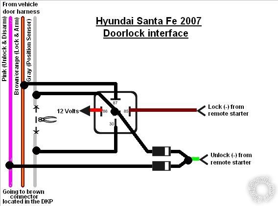

I can answer two of the three questions and i'm sure someone more familiar with the 613 will answer the ignition triggered door locks question. I'm guessing the installer was lazy and didn't hook up the horn output or didn't program the 613 to honk on second lock. The door unlock problem is common with a inexperienced installer. For an unknown reason hyundai made it so the door unlock stops working 45 seconds after locking with the factory remotes or locking with the door open. The fix for this is for the installer to wire a relay for driver door priority or pulse the "door unlock detection wire" and turn on the double unlock pulse option on the 613. Hope this helps.

this is what beegbie is talkin about.
2008 santa fe, astrostart 613 problems -- posted image.

thanks for your input! I will show them this info when I take the car back tomorrow.
